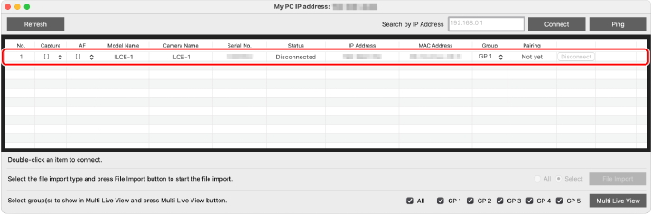

    3. Launch Remote Camera Tool and, from the Device Selection Window, select [File] → [Network Configuration File Setting].
    4. Follow the instructions on the screen to specify the Network Configuration File you created.
    5. When the camera you wish to connect to appears in the Device Selection Window, double-click on it to connect.
      Device Selection Window showing camera information.
      When the connection is established, the Camera control window is displayed in Single Live View, allowing you to perform various operations.
