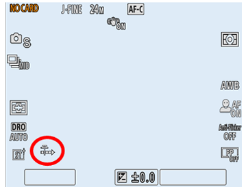

    When pre-capture is switched [On], the (pre-capture) icon will be displayed at the bottom of the screen when shooting still images.
    Pre-capture icon displayed at the bottom of the screen
    Notes
    • The icon will automatically disappear after a continued period of inactivity, unless [DISP (Screen Display)] is set to [Display All Info.].
