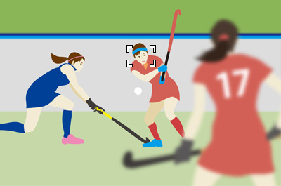

    Tracking starts by using the focus frame set in [Tracking] option in [Focus Area] as the starting point. You can pinpoint a subject to focus on or increase the chances of capturing a subject moving at high speed by setting [Tracking] in accordance with the subject.
    When there are multiple athletes or when the subject is small, set [Tracking] to [Tracking: Spot M] or to [Tracking: Expand Spot]. When you start Tracking, the focus will stay on that athlete without being affected by surrounding subjects.

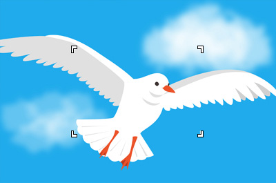

    When there are no other subjects in the area and you want to track a subject that is moving too much, set the [Tracking] settings to [Tracking: Zone] or [Tracking: Wide]. This decreases the likelihood of the focus shifting to the background and makes it easier to capture the subject.

    Situations when [Tracking On] is effective
    Tracking when the subject you want to track is small or not visible due to an obstruction
    1. Track with [Spot] when the subject is far away and small, or not visible due to an obstruction
    2. When the targeted athlete gets closer, keep the shutter button pressed and held halfway down and press [Tracking On]
    3. You can vary the composition during tracking

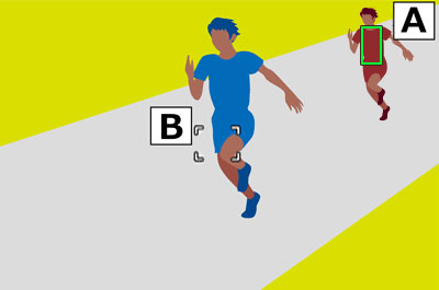

    To stop tracking and track a subject with [Spot]
    In the following example, [Area Disp. dur Tracking] is set to [On]. Both the tracking frame and tracking start area are displayed while tracking the subject.
    1. Set [Spot] to a position where it is easier to capture the subject. Track subject-A with the shutter button pressed halfway down while you press and hold down the custom key to which you have assigned [Tracking On] in advance.
    2. To change the tracking target subject to B
    3. Release the [Tracking On] custom key and track subject-B with [Spot] that was set previously. You can switch between [Tracking] and [Spot] as desired.

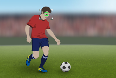

    Operating the tracking and subject recognition function together
    Guide to using the camera
    If you perform in advance the setting to focus on a specific part such as a face or eye using the setting items of [Subject Recognition], the tracking frame will switch to the subject-recognition frame and the recognition frame will automatically move to a face or eye if the face or eye is detected while the subject is being tracked using the tracking function.
    Also, you can use [Tracking Shift Range] to set the range for recognizing the subjects during tracking. Narrowing the range makes the camera shift the focus to a recognized subject only when the subject is close to the tracking frame. Widening the range makes the camera shift the focus to a recognized subject even when the subject is distant from the tracking frame.

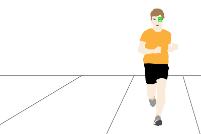

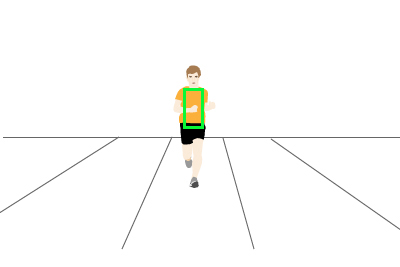

    1. Tracking distant subjects
    2. If the body of a subject is recognized when the face not recognized as the subject being tracked is getting closer, the tracking frame will be switched to the subject-recognition frame and the recognition frame will automatically move to the body.
    3. If the face or eye of a subject is recognized when the subject being tracked is getting even closer, the subject-recognition frame will automatically move to the face or eye.
    4. If the camera cannot recognize an eye because the subject turned away, the subject-recognition frame will automatically switch to the head or body.
