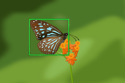

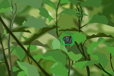

    1. Make sure that the head or entire part of an insect to be focused on fits in the focus area.

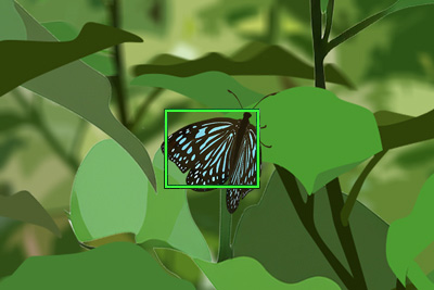

      When [Focus Area] is set to [Tracking: Spot M]
    2. Press the shutter button halfway down to focus. *
      When the camera recognizes the insect and focuses on that insect, a green subject-recognition frame appears on the head or entire part of an insect.
